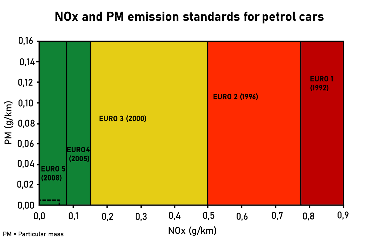

The following diagram states the Euro1-5 definitions of the EU:
And if you scroll down on the mentioned page, you will find a table with the various requires exhaustgas parameter values for petrol cars.
